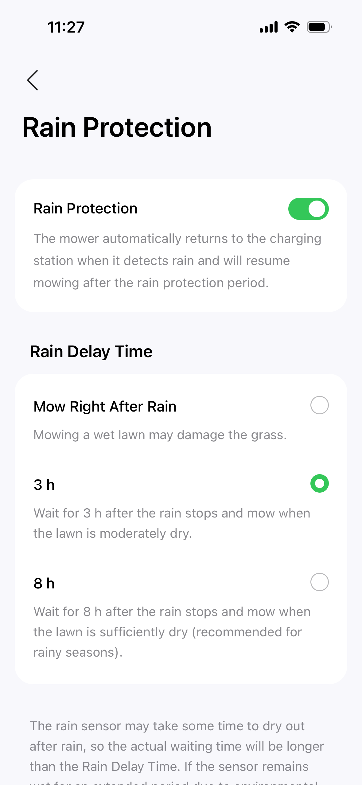

To help with this, the mower includes a built-in rain sensor. When rain is detected, the mower will automatically pause mowing and return to its charging station.
Once the rain stops, the mower will wait for a set amount of time (the “rain delay”) before resuming mowing.

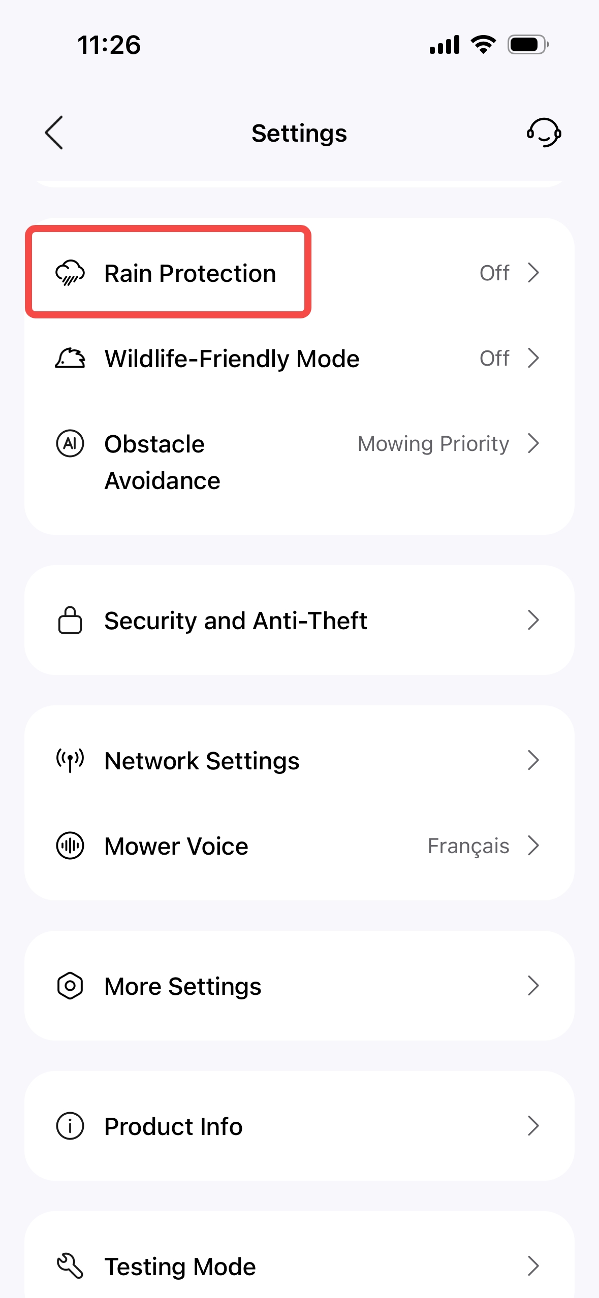

You can customize the rain delay time using the following steps:
Settings → Rain Protection → Turn on Rain Protection → Choose one of the three available rain delay options.
