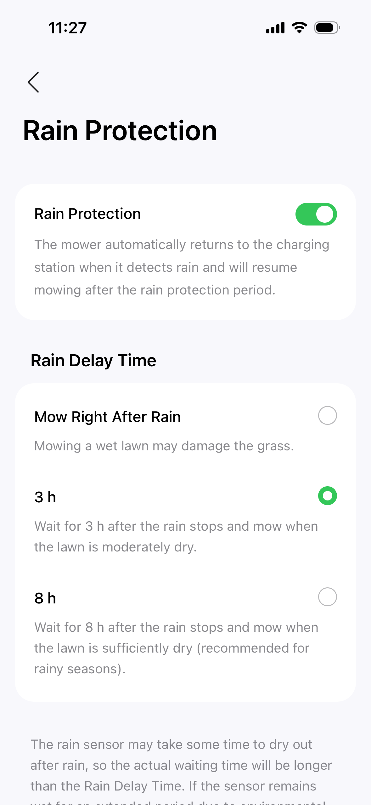

To help with this, the mower has a built-in rain sensor. When it detects rain, the mower will automatically pause mowing and return to its charging station.
Once the rain stops, the mower will wait for a set delay period before resuming mowing. You can customize how long it waits before restarting:

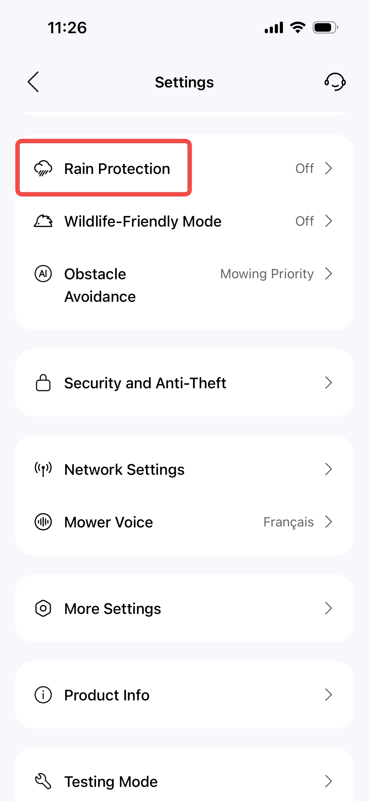

Settings → Rain Protection → Turn on Rain Protection → Choose a rain delay time
Select one of the three available options:
- 30 minutes
- 60 minutes
- 120 minutes
